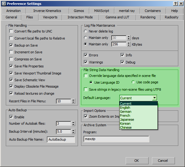

The default Character Encoding of non-scene files is controlled by the Customize > Preferences > File tab > File String Data Handling group of controls.
Override language data specified in scene file
When unchecked, the language data stored in the .MAX scene file will be respected.
When checked, the language data will be overridden.
Save strings in legacy non-scene files using UTF8
When unchecked, text files will be saved as ASCII for compatibility.
When checked, text files will be saved using UTF-8 with BOM encoding.

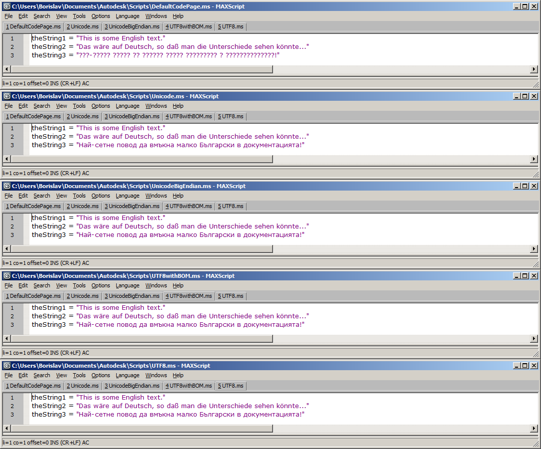

The following script contains three string definitions in three languages - English, German and Bulgarian.
After entering the text in the Scripting Editor of 3ds Max 2013 or higher, the script was saved as Default Code Page, Unicode, Unicode BigEndian, UTF-8 BOM and UTF-8.
After saving the text using all supported encoding standards, the resulting script files were opened again in the Scripting Editor of 3ds Max 2013:
As you can see, all files except for the Default Code Page one reproduce the original multi-lingual content correctly.

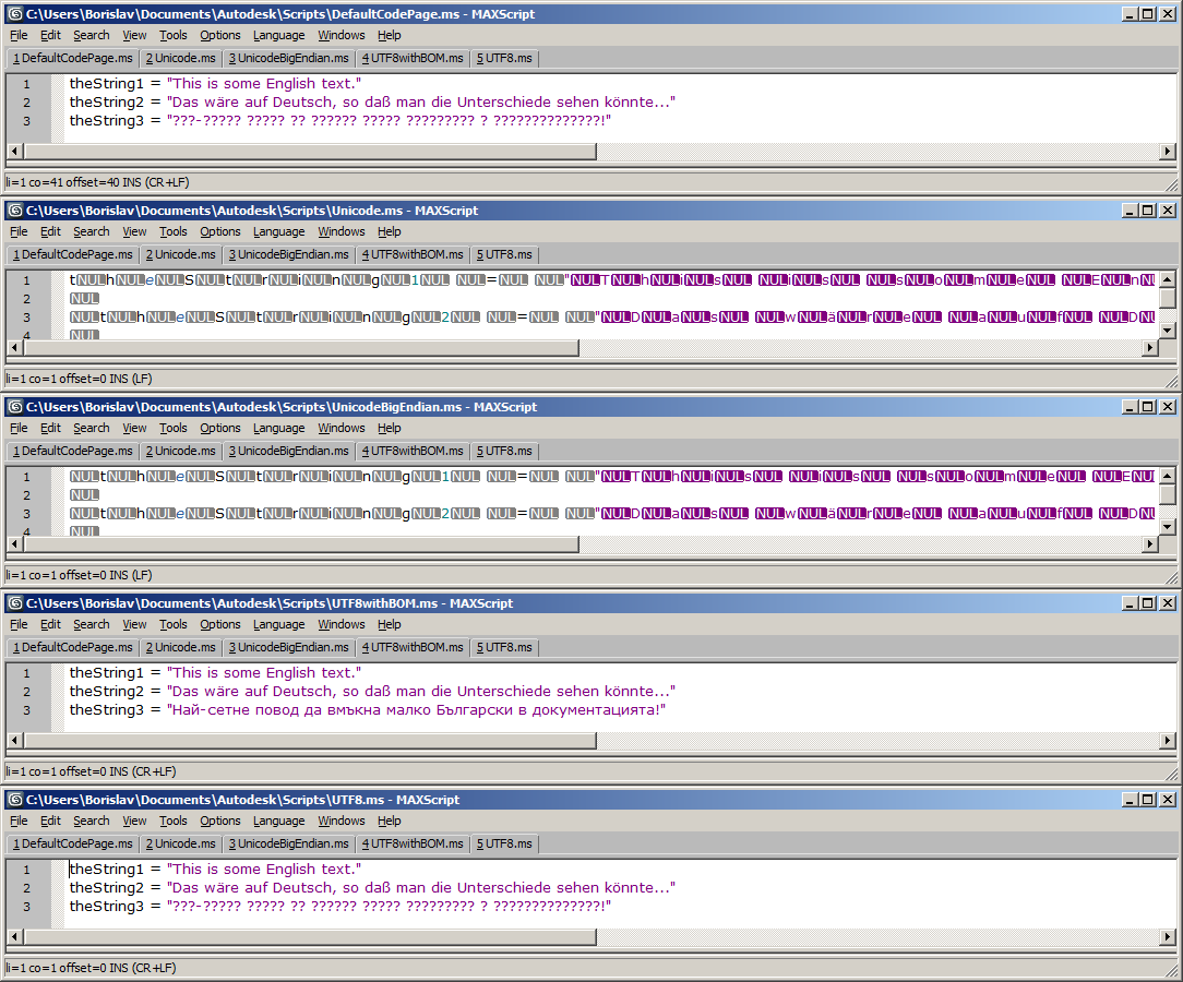

Now let's take a look at the same files loading in the Scripting Editor of 3ds Max 2012:
As you can see, only the UTF-8 BOM encoding was interpreted correctly. The UTF-8 contains the German characters, but completely lost the Bulgarian text. The Unicode is not recognized at all.

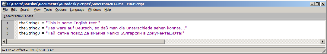

Note that re-saving the UTF-8 BOM encoded file from 3ds Max 2012 opens it correctly in 3ds Max 2013:
