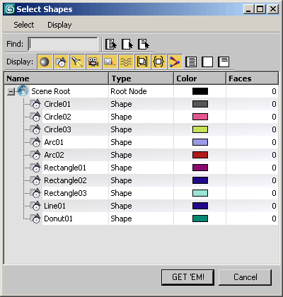

FOR EXAMPLE,
the following function limits the choices to shape objects:
   fn shape_filt obj = isKindOf obj Shape
Then you can call the Select By Name function to select multiple shapes including hidden ones:
   theShapes =selectByName title:"Select Shapes" buttonText:"GET 'EM!" filter:shape_filt showHidden:true single:false
RESULT:
