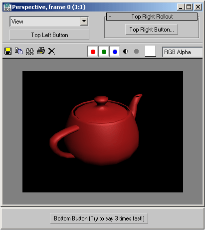

               --Definesome stand-in rollouts to display in the three panels:
               rollout theTopLeftRollout "Top Left Rollout" width:200 height:45
                   dropdownlist ddl_topLeft items:#("View","Region","Crop") width:160
                   button btn_topLeft "Top Left Button" width:160
               rollout theTopRightRollout "Top Right Rollout" width:200 height:50
                   button btn_topLeft "Top Right Button..."
               rollout theBottomRollout "Bottom Rollout" width:200 height:22
                   button btn_bottomButton "Bottom Button (Try to say 3 times fast!)"
               --Initialize the top left panel to a size and
               --get its RolloutFloater value back:
               theTopLeftFloater = VFB_Interface.InitRolloutWindow #TopLeft 200 60
               --Add the rollout to the RolloutFloater without borders and tile bar:
               addRollout theTopLeftRollout theTopLeftFloater border:false
               --and enable the visibility of the top left panel:
               VFB_Interface.SetRolloutWindowVisible #TopLeft true
               --Initialize the top right panel to a size and
               theTopRightFloater = VFB_Interface.InitRolloutWindow #TopRight 200 60
               --add the rollout to the RolloutFloater WITH borders and tile bar:
               addRollout theTopRightRollout theTopRightFloater border:true
               VFB_Interface.SetRolloutWindowVisible #TopRight true
               --Initialize the bottom panel to a size and
               theBottomFloater = VFB_Interface.InitRolloutWindow #Bottom 400 35
               --add the rollout to the RolloutFloater without borders and tile bar:
               addRollout theBottomRollout theBottomFloater border:false
               VFB_Interface.SetRolloutWindowVisible #Bottom true
               VFB_Interface.InitLayout() --finally, initialize the new layout
