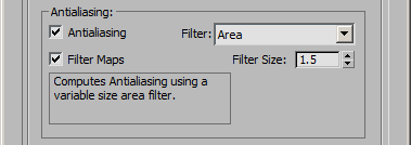

Antialiasing
scanlineRender.antiAliasing
Get/set the state of the Antialiasing checkbox. When set to false, no antialiasing will be performed. Default is true.
scanlineRender.filterMaps
Get/set the state of the Filter Map checkbox. When set to false, texture maps will not be filtered. Default is true.
scanlineRender.antiAliasFilter
Lets you get and set the anti-aliasing filter.
For a list of all of the anti-aliasing filters you can say:
   showClass"*:filter*"
EXAMPLE
   scanlineRender.antiAliasFilter = quadratic()
The anti-aliasing filters and their parameters are described in 3ds MaxDefault Scanline Renderer Anti-Aliasing Filters.
scanlineRender.antiAliasFilterSize
Get/set the antialiasing filter size as a floating point value.
scanlineRender.antiAliasFilterSizeautoReflectLevels

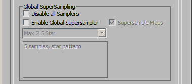

Global SuperSampling
scanlineRender.enablePixelSampler
Get/set the state of the Enable Global Sampler checkbox.
