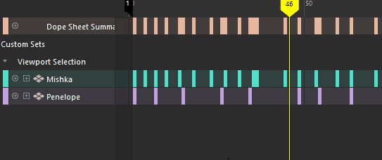

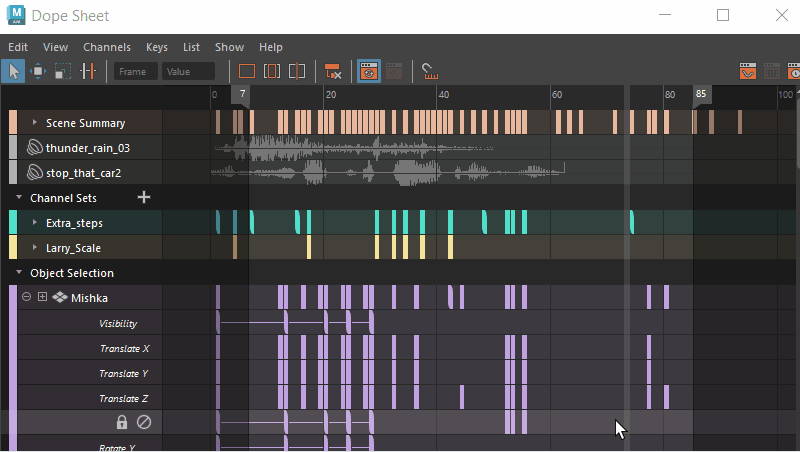

The Dope Sheet Editor (or Dope Sheet) complements the Graph Editor by letting you make large scale timing adjustments to your scene. Unlike the Graph Editor, where you can tweak individual keys on curves, the Dope Sheet Editor lets you easily edit larger sections of animation. For example, pushing animation to start later or slowing down a rotation channel
Use the Dope Sheet to manipulate key times, shown as colored rectangles in the View area. These rectangles represent time units along the horizontal axis. The vertical axis represents the items currently loaded into the Dope Sheet outliner.

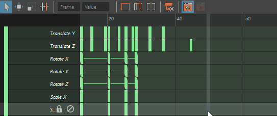

The following table provides an overview of basic tasks using the Dope Sheet. Many navigation shortcuts are the same as in the Graph Editor. For more information about editing with the Dope Sheet, see Edit keys using the Dope Sheet.
To... Do this

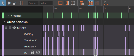

Select a key
Use the Select Tool (Hotkey: Q) on the Dope Sheet Toolbar to select a key in the View area.
Drag to select a group of keys and Shift-click to add non-consecutive keys to the selection.
Note: Select the Move Tool (Hotkey: W) before moving one or more selected keys. See Move keys, below.
Move keys
Select keys and use the Move Tool (Hotkey: W) on the Dope Sheet Toolbar to drag the selection to a new location in the View area using the double arrow cursor.
Double-click the Move Tool icon to open the Move Keys Options to specify how keys are moved: Move Only, Move Over, or Ripple.

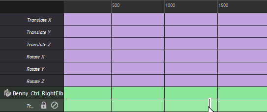

Scale keys
Use the Scale Tool (Hotkey: R) on the Dope Sheet Toolbar to drag-select keys in the View area. Use the double arrow cursor to stretch or shrink the selection.
Double-click the Scale Tool icon to open the Scale Keys Tool settings to specify how to scale the keys: Manipulator or Gestural.

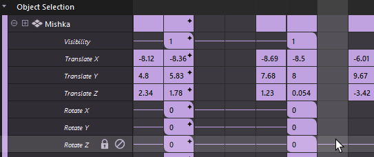

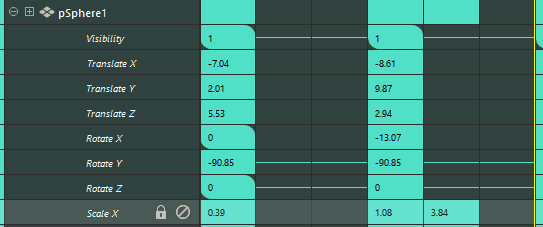

Edit key values
Double-click a key to enter a new value. Show or hide key values using Show key value in the Dope Sheet View menu.
To set the same value for multiple keys at once, Shift-select multiple keys, then Shift-double-click one of the selected keys and enter a value.

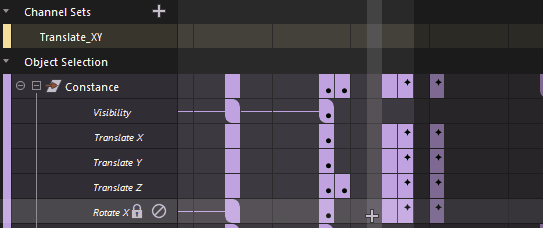

Lock or Mute a channel
Click the Lock icon in the Dope Sheet outliner so that values can no longer be manipulated until the attribute is unlocked. Hotkey: H to lock and J to unlock the channel.
Click the Mute icon in the Dope Sheet outliner to turn off any effect that the key has on the scene.
Show or hide attributes
Right-click in the Dope Sheet Outliner and select Collapse/Expand All Attributes.
Create a Channel Set
Right-click the + next to the Channel Set header in the outliner to create an empty Channel Set, or right-click the name of a channel in the Dope Sheet Outliner and select Channel Sets > Create Channel Set.

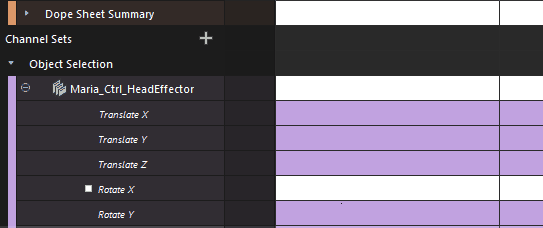

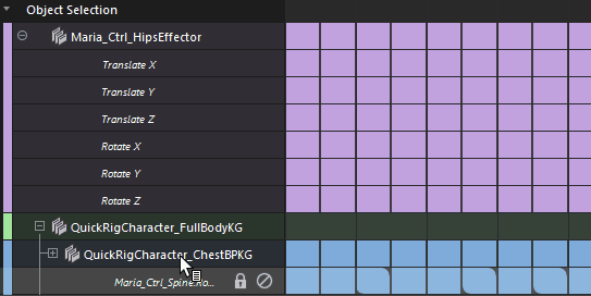

Expand key structure
Click the plus sign in the square to expand one level below a node. Click the plus sign in the circle to expand the corresponding attributes. Shift-click an expand control to expand all child levels below the node.

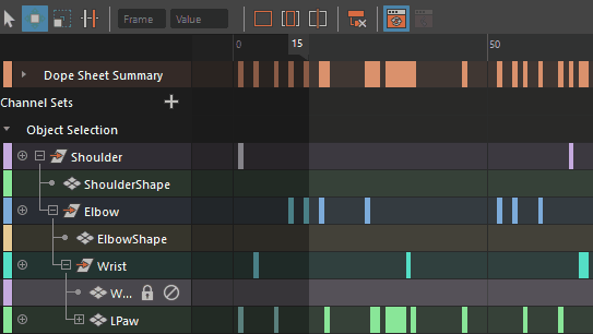

Show child keys with the parent Click Hierarchy Below on the Dope Sheet Toolbar.
