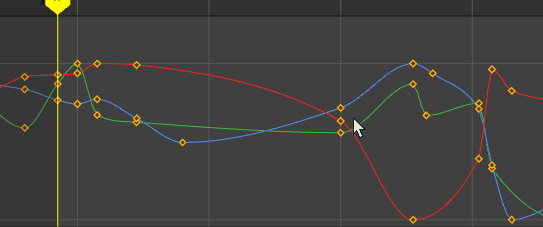

Graph Editor Tangents menu
Tangents describe the entry and exit of curve segments from a key. This menu operates on the shape of curve segments around selected keys. Note that these settings affect only existing animation curves segments’ tangents.
Stepped and Stepped Next are toggle options that affect out tangents only. When you turn off either option, Maya restores the previous out-tangent types and preserves your tangent edits.
Tip: You can also edit tangents using the marking menu. Shift + S + click in the Graph Editor to display the marking menu and swipe right to choose tangents.
The animations displayed below show how a curve with default Auto tangents is changed by a different tangent choice. The original curve appears in a blue Buffer curve for you to compare how your choice of tangents affects the curve shape.
