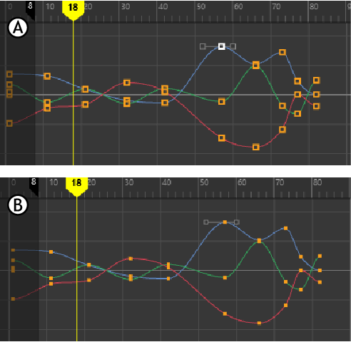

Key View
Lets you switch between the default Detailed Key View (A) and Simplified Key View (B)
Key View: A Detailed, and B simplified
Detailed key view
The Graph Editor default view, Detailed key view, gives you visual cues about keys and tangents, such as showing filled or hollow keys that show whether a key has been edited or is automatic or identifying the type of curve. This feedback provides a quick way to identify the state of the animation you're working with.
Simplified key view
Simplified key view contains less visual information on the keys.
If you want to simplify your view to show only the key you're working on, or the curves without keys, see Keys, above, and change the setting to Active.

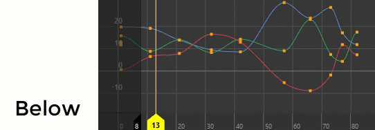

Time ruler Placement
Lets you change the position of the Graph Editor Time ruler so that you can align it with the Time Slider. Choose between Top or Bottom.
