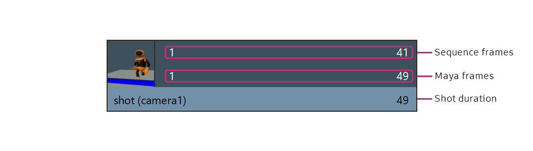

Shots in the Sequencer editor represent the frame ranges during which a specific camera is active. Shots let you control and adjust the timing of each camera within a sequence.

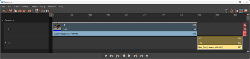

Shots are displayed as rectangular blocks arranged on tracks in the Sequencer editor. You define the order and duration of active cameras by moving, scaling, and trimming shots relative to one another. By adjusting shots, you manage how the scene is sequenced and played back.

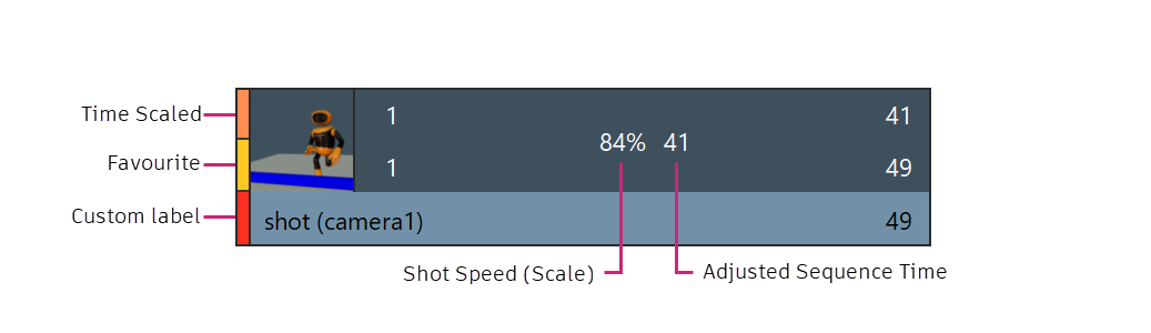

Camera shot overview
Note: To display all shot values in the Sequencer editor, set the track height to the tallest setting. If the track height is set to Medium or Short, some values may not be visible.

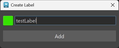

Create and assign a label
To create a new label and assign it to a shot:
  1. Select a shot.
  2. Right-click the shot and choose Assign Label > Create Label.
  3. Sequencer - Create label dialog
  4. In the dialog box, enter a name for the label.
  5. Choose a color.
  6. Click Create.

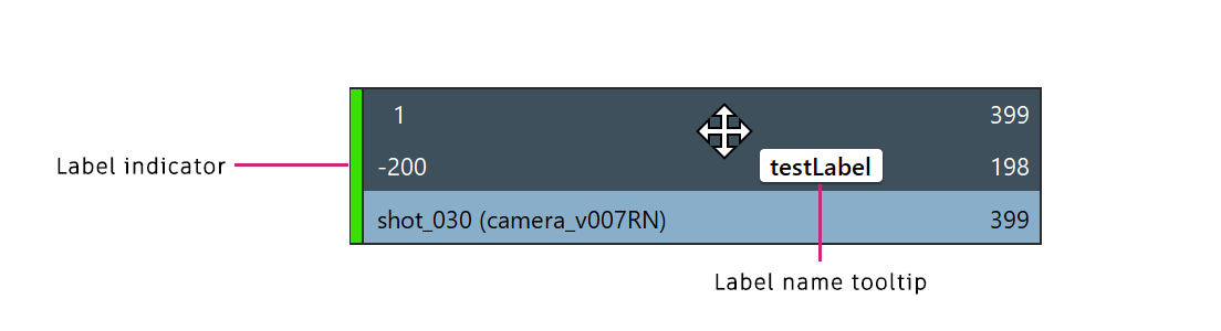

Sequencer - Shot label colour and tooltip
A colored bar appears on the left side of the shot, indicating the assigned label.
When you move the cursor over the shot, the label name appears in a tooltip.

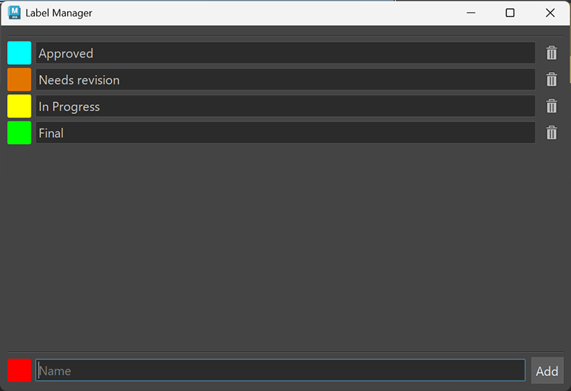

Manage labels
You can manage labels using the Label Manager.
To open the Label Manager:
  1. Right-click a shot.
  2. Select Assign Label > Label Manager.
In the Label Manager, you can:
  • Add new labels and define custom colors.
  • Delete existing labels using the delete (trash) icon.
Sequencer - Label manager
Changes to labels are stored with the scene.

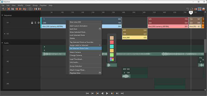

Set shot colors
You can customize the display color of shots in the Sequencer editor.
Setting a shot color changes how the shot appears in the timeline and can be used to visually organize shots within a sequence.
Change the color of a shot
To change a shot's color:
  1. Right-click the shot.
  2. Select Set Selected Shots Color.
  3. In the color picker, choose one of the preset swatches or select a custom color.
  4. Click to apply the selection.
The shot updates to display the selected color in the Sequencer timeline.
