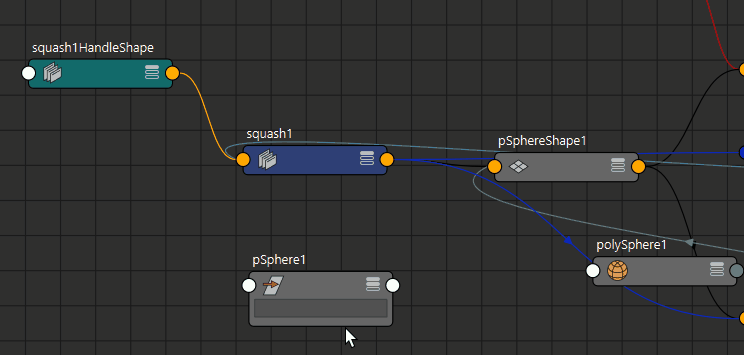

Intermediate Objects
Display Intermediate Objects
Turns on the visibility for the current object’s original (prior to deformation) shape. You can use intermediate objects as points-of-reference when deforming objects. For example, you can compare a deformed object and its intermediate object to determine how different the deformed object is from its original shape.
See also Displaying and hiding intermediate objects.
Hide Intermediate Objects
Turns off the visibility for the current object’s original (prior to deformation) shape.
