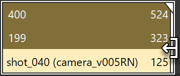

Trim and scale shots using shot edges
In the Sequencer editor, trimming and scaling shots is performed using the edges of the shot. You switch between Trim Mode and Time Scale Mode using the Sequencer toolbar.
Trim a shot
To trim a shot:
  1. Move the cursor over the in or out edge of the shot.
  2. When the trim cursor appears, click and drag the edge to adjust the shot length. If Hold mode is enabled, dragging the edge creates hold frames instead of trimming the shot.
Trimming changes the shot's sequence start or end time without altering the Maya time defined within the shot.

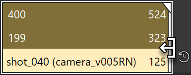

Scale a shot
To scale a shot:
  1. In the Sequencer toolbar, enable Time Scale Mode.
  2. Move the cursor over the in or out edge of the shot.
  3. When the time scale cursor appears, click and drag the edge.
Scaling adjusts the relationship between sequence time and the shot's Maya time.
To return to trimming behavior, click Time Scale Mode again to deactivate it.
Switching between Trim Mode and Time Scale Mode
  • When Time Scale Mode is disabled, dragging a shot edge trims the shot.
  • When Time Scale Mode is enabled, dragging a shot edge scales the shot.
The cursor icon changes to indicate the active mode.

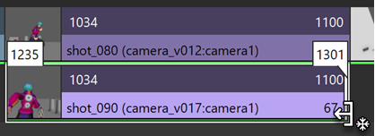

Create and edit holds on shots
A hold extends a shot by holding its first or last frame (freeze frame) for a specified number of frames before or after the original shot range.
To create a hold:
  1. Enable Hold mode in the Sequencer toolbar.
  2. Select a shot.
  3. Drag the in or out edge of the shot.
Dragging the left edge creates a pre-hold. Dragging the right edge creates a post-hold.
The hold duration updates interactively as you drag.
Note: Hold frames are created only when Hold mode is active. Dragging shot edges without Hold mode trims the shot.
