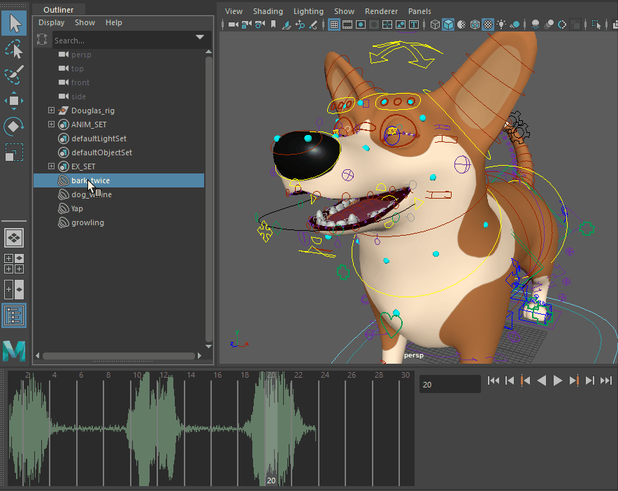

Sounds
This section lists the imported sounds to be displayed on the Time Slider and only shows the 30 most recent sounds added to the scene. (If there are more than 30 sounds in your scene, they are visible in the Outliner.

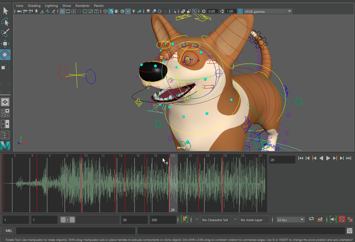

Use Trax Sounds
Plays all the sounds in the scene. When Use Trax Sounds is active, and there is more than one audio file in the scene, the waveform becomes a solid line. If you want to offset the files so they play back at different times, see Create Audio offsets in the Play an Audio File topic.
Use Sequencer Sounds
The Use Sequencer Sounds option in the Time Slider Audio menu restricts playback to audio associated with the Sequencer.

Note: The Audio menu only displays the 30 most recent sounds added to the scene. If you have more than 30 sounds in your scene, you can delete them from the Outliner.

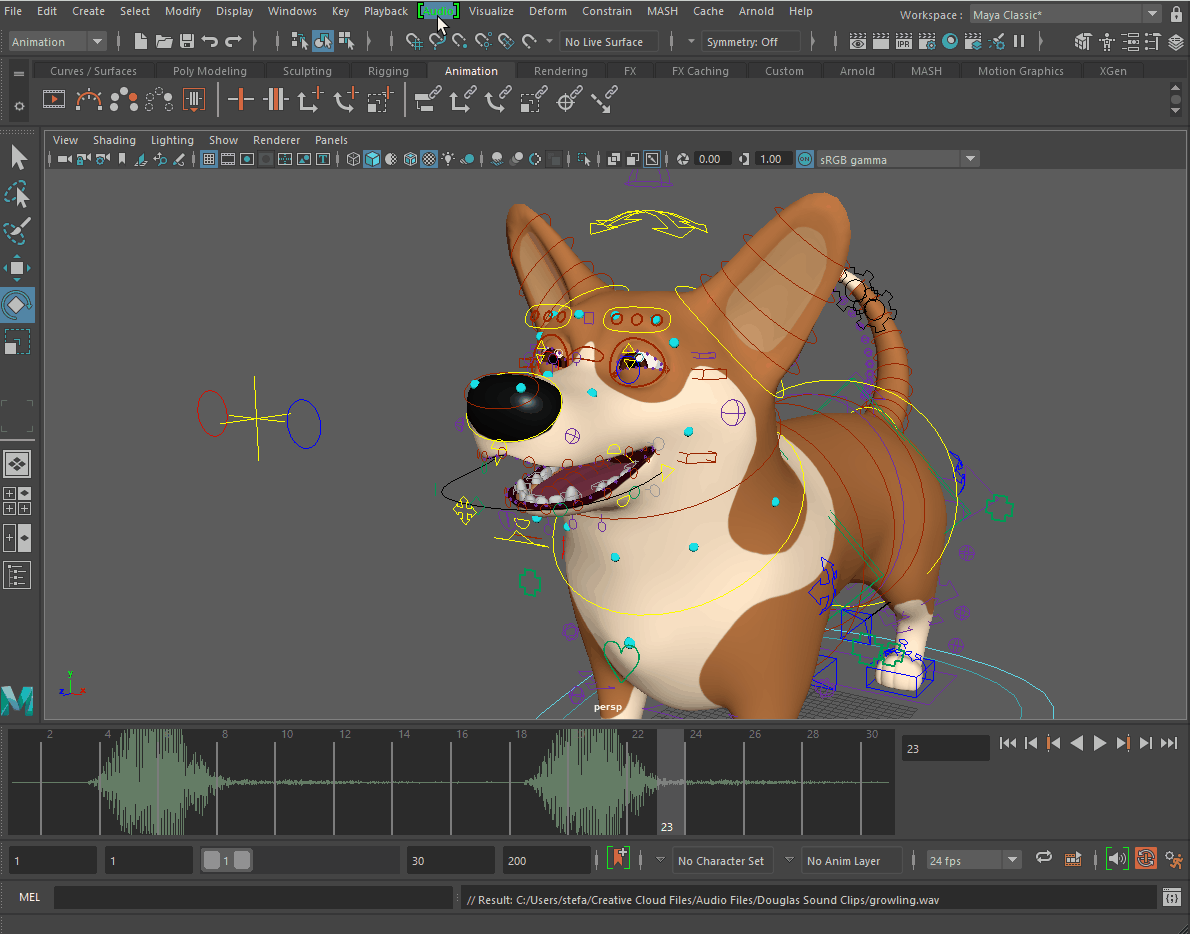

Waveform Display
Lets you set the way that waveform is drawn on the Time Slider. Choose from Top, Bottom, or Centered.
Three positions of the waveform on the Time Slider: Centered, Top, and Bottom
This setting becomes the default setting and persists until it is changed.
