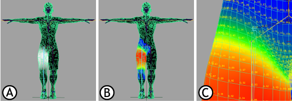

    When you select an influence to paint, the mesh displays weighting feedback (by default) in black and white, with smaller values shown as darker, and larger values shown as lighter.
    Use the Color Ramp or Numeric feedback under the Visualization heading to identify the weighting influence by showing them in colors, number values, or both.
    Weight Visualization options: A. Default color B. Color Ramp C. Numeric values
