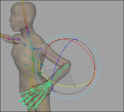

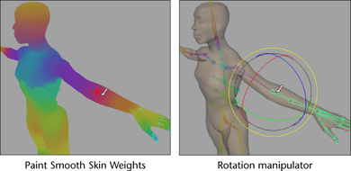

  3. In the scene view, middle-click the mouse to switch from the Paint Skin Weights Tool brush to the Rotation manipulator.

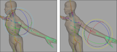

  4. Middle-click the rotation axis you want to rotate about, and middle-drag to rotate the joint about the selected axis.
  5. Press the Up and Down Arrow keys to select other joints up or down the joint hierarchy. For example, walking up the joint hierarchy to LeftArm (shoulder) or down the hierarchy to LeftForeArmRoll.
