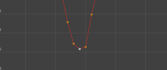

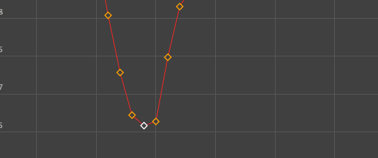

Auto-adjust key size on zoom
Auto-adjust key size on zoom on
Turn on this option so that Graph Editor keys resize to stay in scale with the curve when zooming in the Graph Editor Graph view. If unchecked, keys stay the same size regardless of how far you zoom out.
Auto-adjust key size on zoom off

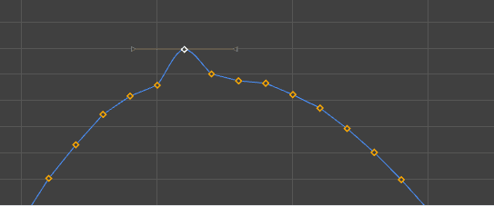

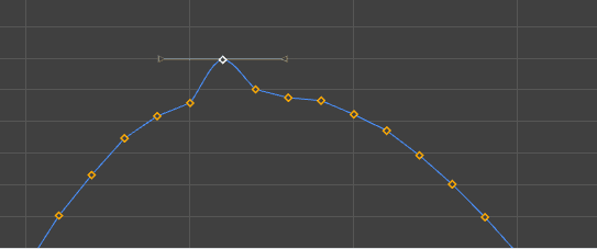

Tangent handle size
Adjusting the Tangent handle size
Enter a value or use the slider to make the Tangent handle larger or smaller.
Tangent Line thickness
Adjusting the Tangent arm size
Enter a value or use the slider to make the Tangent arm thicker or thinner.

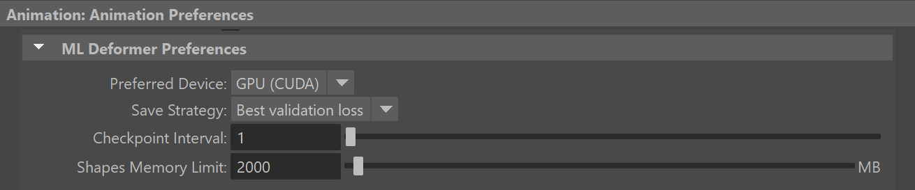

ML Deformer
Note: The ML Deformer preferences appear only if an ML Deformer is loaded in the scene. For information on using the ML Deformer, see Create an ML Deformer and Create an ML Deformer using separate Target geometry.
The ML Deformer Device Settings let you choose between CPU and CUDA-based GPU training.
Device Settings
Select a Preferred Device Type from the ML Deformer Device Settings menu.
Note: Both GPU (Cuda) and CPU options are available for Windows and Linux. CPU is the only Mac option.
Option Description
GPU (Cuda) The default setting. If you do not have a compatible version of Pytorch, CPU is used instead.
CPU Use CPU if you are working with the default GPU version, but prefer to train on CPU, for example, if there is not enough GPU memory.
Checkpointing
When using a Save Strategy other than "Latest", training will periodically reserve model states based on the save strategy. If training is canceled, the last checkpoint will be saved for use. When training is finalized, the latest checkpoint (or latest model iteration) will be saved to disk.
Save Strategy
Controls how the model checkpoint will be updated during training. It has three options.
Best validation loss (default): Tracks the model with the best validation set performance. This approximates how well the model will perform on new animations and is the recommended setting. Will fall back to best training loss if a validation set is not used during training.
Best training loss: Tracks the model with the best training set performance. This can be useful if the model is meant to be optimized specifically for animation that is present in the training set.
Latest: The latest available model will be saved at the end of training
Checkpoint Interval
How many training epochs should pass before checking if the checkpoint should be updated. Typically, this should remain at 1 to preserve the best model quality.
Shapes Memory Limit
The amount of memory allocated to training poses generated from SVD analysis. The default value is 1.2 GB.
If you attempt to analyze more shapes than the memory limit can accommodate, Maya will display a warning message instead of performing the action.
Note: This value affects only the training pose data, not the total memory used by SVD analysis (which will be several times more).
