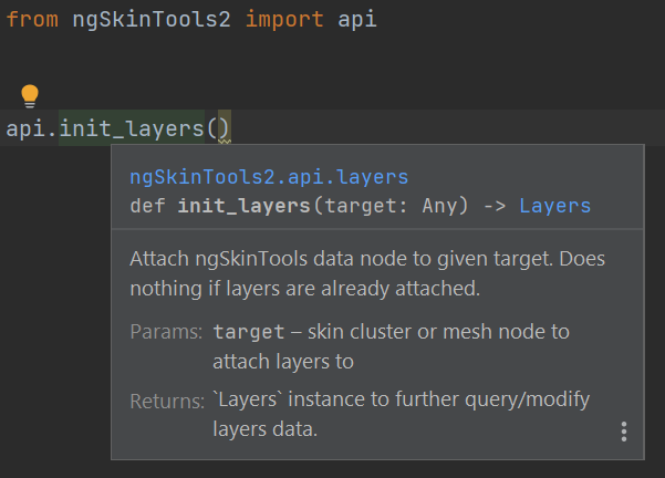

IDE setup
If you have IDE that is able to parse documentation from code, consider configuring your project to index the plugin source directly.
For example, in PyCharm, go to Settings | Project | Project Structure, click "Add Content Root" and add the following directory which can be found inside your Maya install directory: runTime/plug-ins/ngSkinTools/scripts/ngSkinTools2
After configuring this, you should be able to see documentation directly in UI, and have auto-complete on various API objects, e.g. attributes for Layer properties. For example, press ctrl + q to quickly check function reference.
