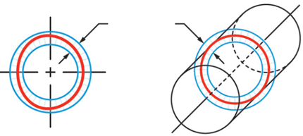

  3. Select a node that is on a rounded edge.
    By default, Auto select edge is applied. When you select an edge node, all nodes on that edge are automatically selected.
    roundness selection
    • Click Auto select edge to turn off the autoselect, and select the nodes manually.
  4. Enter a unique name in Selection name, that describes the selection, so you can associate it later with the selected edge.
