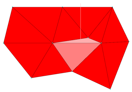

  11. Click Mesh tab > Entity Navigator and select T311 from the drop-down box.
    A High Aspect ration triangle is displayed. To understand how to deal with a high aspect ratio element, you need to see the adjacent elements.

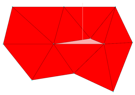

  14. Click swap edges icon (Mesh tab > Mesh Edit panel > Swap Edges).
  15. Select the element with the high aspect ratio, which has the spike protruding from it.
    aspect ratio 8 The element number T311 will appear in the Select first triangle box of the Swap Edge tool pane.
  16. Click the element attached to the long edge of the high aspect ratio element:
    aspect ration 9 The second element's number T7672 will appear in the Select second triangle box of the Swap Edge tool pane.

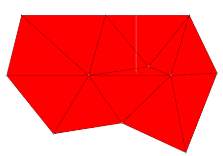

  17. Click Apply.
    The high aspect ratio element has been eliminated by altering the nodes that are joined to form the local surface.

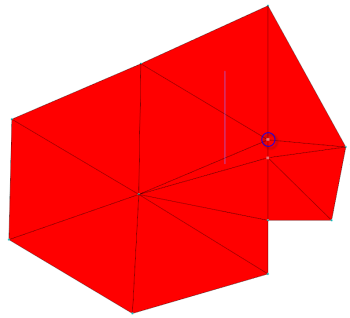

  19. Click Mesh tab > Entity Navigator and select T497 from the drop-down box.
    aspect ratio 2
    Previously we swapped edges to resolve the high aspect ratio element. In this instance, we would replace a high aspect ratio element that runs across the screen with one that runs up the screen. We need a different approach, which is to merge nodes.

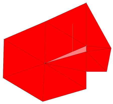

  21. Click on one of the nodes along the short edge of the high aspect ratio element. This first node is the target of the merge.
    aspect ratio 3

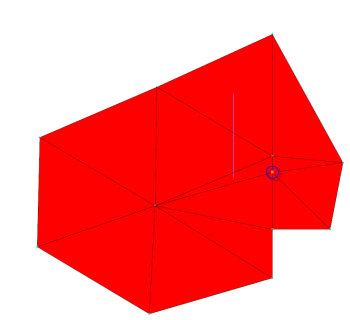

  22. Click on the other node along the short edge of the high aspect element. This is the node that will be merged onto the target node.
    aspect ratio 4
    The sequence of node selection will alter the resultant merge. Autodesk Moldflow Insight has filled in the node identification numbers in the Input Parameter boxes of the Merge Nodes pane.

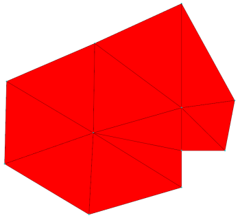

  23. Click Apply.
    The second node is merged into the first node, and the surrounding elements are adjusted accordingly.
    aspect ratio 5
