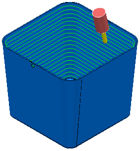

  3. Create a constant Z toolpath, the tool starts off vertical.
    Then a lean angle is applied so that the tool holder just clears the model.

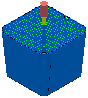

    As the toolpath proceeds down the model, the lean angle changes so that the tool holder just clears the model:

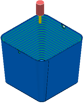

    And so on down the model:
