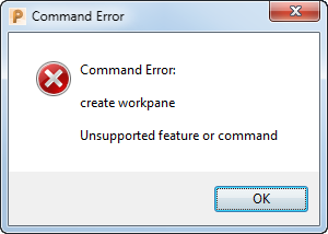

Show command errors — When selected, PowerMill displays the invalid command messages in the dialog. For example, if you type a command incorrectly, such as "Create Workpane" instead of "Create Workplane".
When deselected, PowerMill displays the message in the command window, for example:
In most instances it is better to display errors in dialogs as it draws your attention to the error and PowerMill does not continue until you have responded to it. However there are instances when you may want to ignore any errors (such as when running automatic tests).
