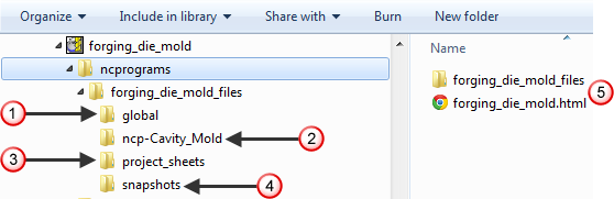

Folder structure
Exporting setup sheets writes them to the specified export folder. The following export structure is created under the ncprograms folder:
— global folder contains the various images (such as tools and logos), and cascading style sheet.
— ncp-xxxxx folder contains the setup sheets specific to a given NC program, where xxxxx is its name as shown in the Explorer.
— project_sheets folder contains the project-specific setup sheets.
— snapshots folder contains all the snapshots that you have taken.
— additionally, the <export file>.html file is created in the ncprograms folder. You can use this file to navigate through the created setup sheets.
Tip: To remove the exported setup sheets together with the folder structure, delete the <export file>.html file from the ncprograms folder.
