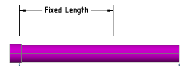

  1. Route a length of fixed-length pipe that exceeds the length of the Fixed Length property.
  2. If your piping does not create additional segments at the maximum length, do the following to check pipe properties:

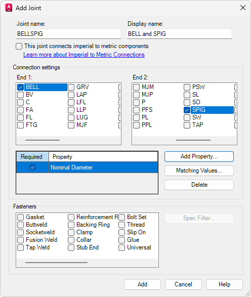

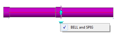

  3. If your pipe segment length (Cut Length) exceeds the Fixed Length value, do the following to check joint configuration:
    • In the Properties palette, under Port Properties, note the end types (for example: BELL, SPIG).
    • In Project Setup, expand Plant 3D DWG Settings and Piping Connection Settings to display the Joint Setup settings.
    • If a joint does not exist to connect the end types, click Add to create one.
      Note: You can create new end types. For more information, see Connections. If fasteners are specified, they must exist in the pipe spec.
    • Close Project Setup.
