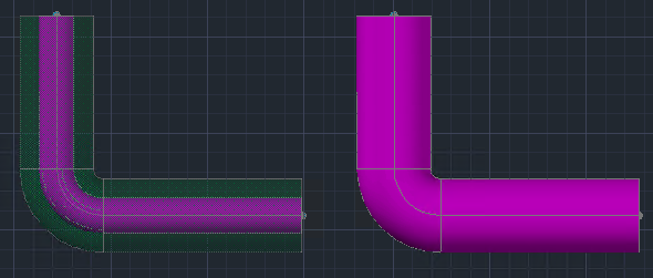

Controls whether the insulation is displayed on an individual layer or on the same layer as piping.
Type:Switch
Saved in:Registry
Initial value:1
Value Description
0 Show piping insulation in an individual transparent layer.
1 Show piping insulation in the same layer as pipe.
Use PLANTINSULATIONUSEPARTLAYER system variable to show the insulation as an individual layer or same as the piping layer before you append the 3D piping drawing into Navisworks.
