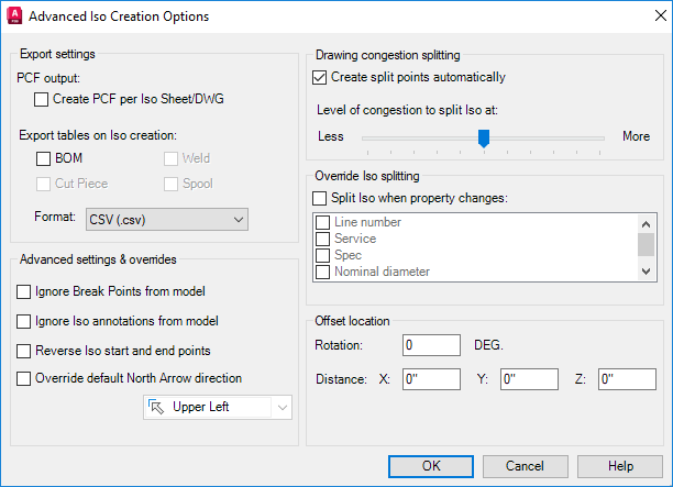

Advanced Iso Creation Options Dialog Box
Specifies advanced settings for creating Iso drawings.
Export Settings
PCF Output
Defines whether to create single pcf per iso sheet or DWG.
Export Tables on Iso Creation
Creates data files from the tables. Tables must exist in the title block to be exported.
Format
Sets the format of the table data file (CSV, Microsoft Excel or text).
Advanced Settings & Overrides
Ignore Break Points from Model
Ignores break point markers.
Ignore Iso Annotations from Model
Ignores Iso message and location markers.
Reverse Iso Start and End Points
Assumes the opposite flow direction for the line to reverse sheet order. Flow direction is not a property in the model. An arbitrary (but consistent) flow direction is assumed that you can reverse.
Override Default North Arrow Direction
Ignores the North arrow direction specified in the title block.
Drawing Congestion Splitting
Create Split Points Automatically
Enables the automatic creation split points for iso drawings.
Level of Congestion to Split Iso At
Specifies a preference for the number of objects allowed in an Iso drawing sheet compared to the number of sheets generated. Setting a High congestion level will result in fewer sheets, with more objects on each sheet.
The Maximum setting will force the iso onto one sheet if possible (this replaces the Force Iso onto One Sheet option from earlier versions).
Override Iso Splitting
Split Iso when Property Changes
Changes sheets when any of the specified model property values change.
Override Location
Rotation
Rotates objects in the isometric drawing. You can enter negative values (for example: -90). Offset rotation is calculated before offset location.
Distance
Adds X , Y and Z values to objects in the isometric drawing. You can enter negative values (for example: -10000).
