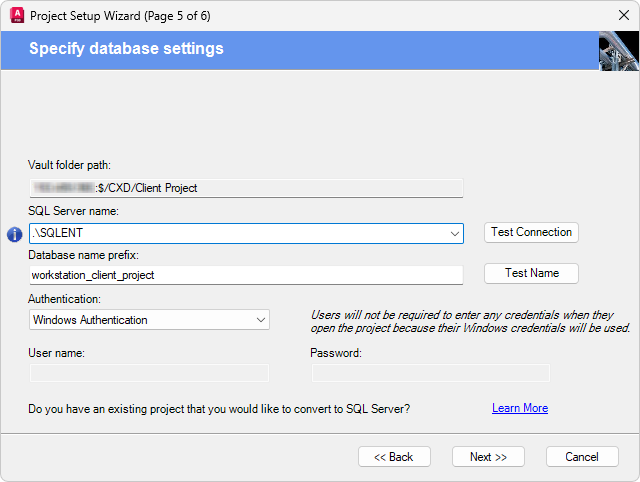

- In the Specify database settings page, specify the server and plant project database prefix.
You must use SQL Server for vault projects. You can use the same
SQL Server that Autodesk Vault uses, but the
Database is different for each plant project.

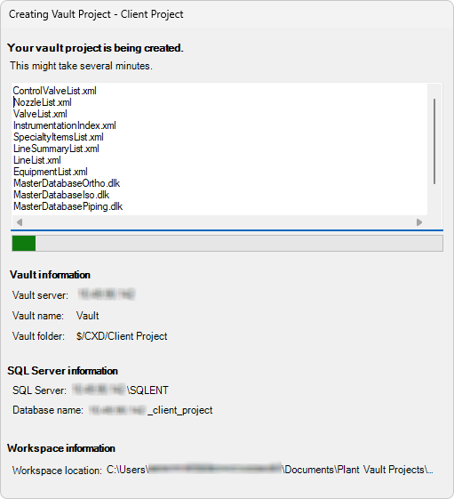

- Click Next and Finish to close the project setup wizard.
The project is uploaded to the vault server.
