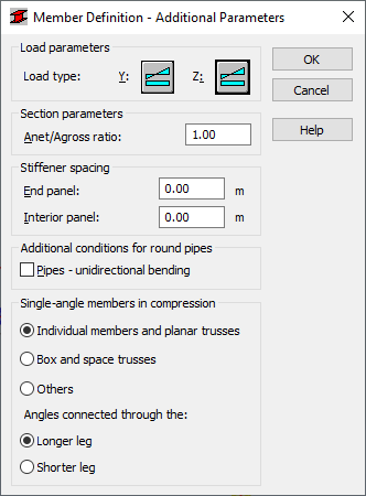

Use this option to define additional code parameters for the steel member type according to the CAN/CSA-S16.1-94, CAN/CSA-S16-01 + Supp. No.1 (2005), CAN/CSA-S16-09, CAN/CSA-S16-14, and CAN/CSA S16:24 codes. Access the parameters by clicking the More button in the Member definition - parameters dialog.
The following parameters are defined:
By selecting an option from this field you can define a function of single-angle members in a structure and how they are connected with gusset plates. Depending on a selected option, Robot calculates the equivalent slenderness of the element in compression according to Section 13.3.3. Thus calculated slenderness will be used for the buckling check for the directions Y and Z.
