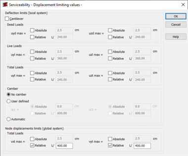

Use this dialog to define additional parameters determining the limit displacement values according to the ANSI/AISC 360-05, ANSI/AISC 360-10, and ANSI/AISC 360-16 codes.
Access
Dialog elements
Deflection limits (local system)
Allows you to check displacements such as Dead loads, Live loads, or Total loads with camber for regular steel members.
Note: The program currently checks regular steel members only.
For each of the displacements that you want to check, specify if the limiting values are relative or absolute, and then enter the member deflections in the Y and Z directions.
Cantilever
Specify if the member is a cantilever.
Camber
Contains the camber properties.
No camber
Select this option to ignore the camber value during the member verification or design.
User-defined camber
Specify the ucy and ucz values for the camber.
Automatic camber
Uses the camber value calculated by the program.
Note: The program uses the dead loads to calculate the automatic camber value.
Node displacements (global system)
Allows you to define the limits for the displacements of vertical members.
The program checks the difference between the upper and lower displacements, and then compares it with the limit value.
Specify the node displacements in the X and Y directions.
