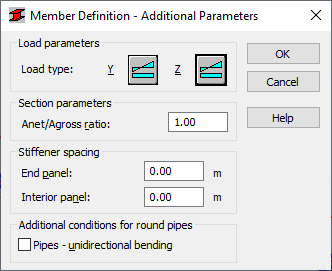

Use this option to define additional code parameters for the steel bar type according to the CAN/CSA-S16.1-94, CAN/CSA-S16-01 + Supp. No.1 (2005), CAN/CSA-S16-09, CAN/CSA-S16-14, and CAN/CSA S16:24 codes. Access the parameters by clicking the More button in the Member definition - parameters dialog.
The following parameters are defined:
This value applies to a tensile force acting on the cable. It is a coefficient that defines the relationship of the member cross-section area, not considering the bolt or rivet openings (Anet), to the total cross-section area (Agross).
