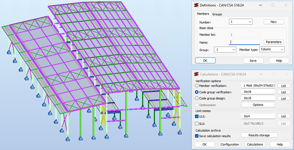

Steel member design according to CAN/CSA-S16-2024.
For the Canadian market, Robot Structural Analysis 2027 introduces:
- Steel design code CAN/CSA-S16-2024
- Steel profile database (CISC 12) - new edition
To find this new steel design code:
- Click Tools
Job Preferences. The Job Preferences dialog opens.
- Select Design Codes in the left panel of the Job Preferences dialog.
