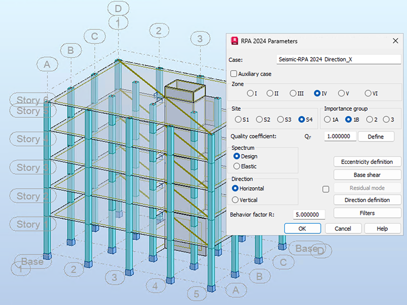

Seismic Analysis for Algeria
Algerian seismic design code, Regles Parasismiques Algeriennes RPA 2024.
The implementation includes two methods and comprehensive analysis calculation notes.
All the codes are set as default in the relevant regional settings.
To find this new seismic code:
  1. Click Tools Job Preferences Design Codes. The Job Preferences dialog opens.
  2. Select Loads in the left panel of the Job Preferences dialog.
  3. Click the Seismic loads drop-down list to see the list of available codes.
