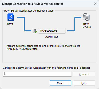

  1. Click Collaborate tabSynchronize panel drop-down Manage Connection to Revit Server Accelerator.
    The dialog indicates which accelerator you are connected to, and its current status.
  2. To connect to a different accelerator, do the following:
    1. Enter its server name or IP address.
      Note: You cannot switch to a different accelerator if multiple Revit sessions are open, a server-based central model is open, or the accelerator is not available.
    2. Click Connect.
      When a valid connection is established, the successful connection status icon displays and the server name updates.
  3. Click Close.
