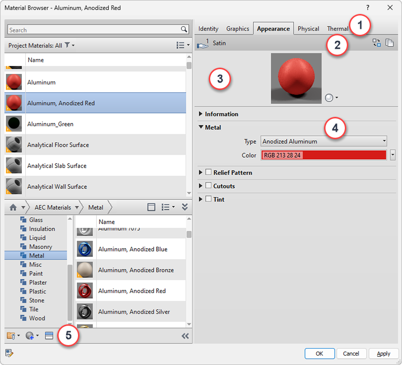

Material Editor Panel
The right pane of the Material Browser dialog is sometimes referred to as the Material Editor panel, or just the Material Editor. Use the Material Editor panel to review or edit the assets and properties of a material. Only materials in the current project can be edited. When you select a material in a library, the Material Editor panel properties are read-only.
Region Function
1 Asset tabs and Add Asset button : The asset tabs (for example: Identity, Graphics) let you view and manage information and properties that describe the material. The Add Asset button displays only when you can add an asset to the material.
The Physical and Thermal tabs display only when these asset types have been added to the material.
2 For Appearance, Physical, and Thermal assets only, the following icon and buttons display along the top of the Material Editor panel:
  • The Hand\sharing icon indicates how many materials in the current project share (use) the selected asset. If the hand displays a zero, the asset is not used by any other materials in the current project. It is only used by the currently selected material.
  • The Replace Asset button replaces the current asset.
  • The Duplicate Asset button duplicates the current asset.
3 Thumbnail (Swatch) options menu: On the Appearance tab, the pull-down menu next to this thumbnail (swatch) image presents a list of options that control the render quality and the appearance of the thumbnail (swatch).
4 Properties panel: Display and manage detailed properties of the selected asset. The asset name and description are displayed beneath the Information drop-down panel. This example above shows the Metal properties being displayed (expanded) for the "Anodized - Red" Appearance asset. The set of properties that are displayed for a liquid, for example, differ from the set of properties displayed for metal.
5 Material Browser toolbar: These buttons let you create a material, duplicate the current material, and display or close the Asset Browser. If custom parameters are available in the current project, the Custom Parameters button displays here.
