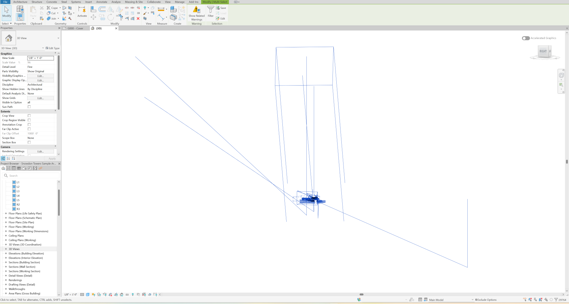

               trans.Commit();
Running the Sample Macro with sample Revit model Snowdon Towers sample Architectural.rvt in a newly created 3D othorgraphic view and Zoom to Fit:
