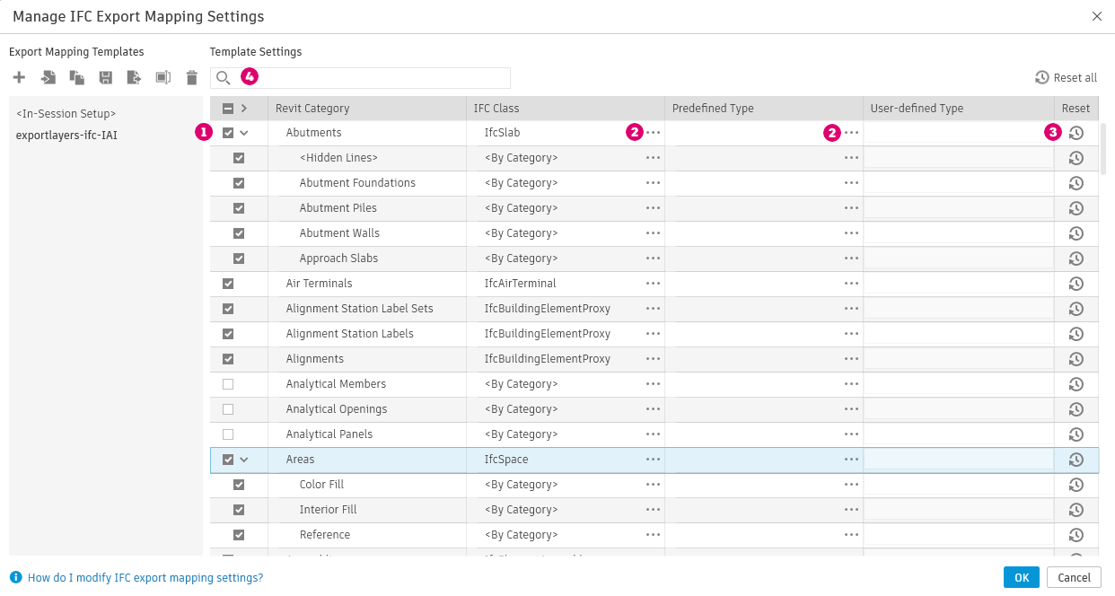

Manage IFC Export Category Mapping Settings
Create and manage templates for use when exporting Revit models to IFC.
Export Category Mapping Templates
Select the mapping template for use when exporting to IFC. Use the default templates, or duplicate, edit, and save custom templates. IFC category mapping files (.txt) can be imported and exported from the dialog.
Template Settings
Make changes to the IFC Class and Predefined Types mapped to each Revit category when exporting an IFC file.
