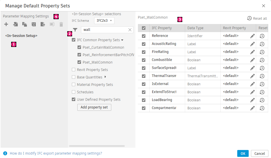

Create and manage templates for use when exporting Revit models to IFC.
Select the mapping template for use when exporting to IFC. Use the default templates, or duplicate, edit, and save custom templates. IFC parameter mapping files (.txt) can be imported and exported from the dialog.
(Create new template) - Create a new template for IFC export parameter mapping.
(Import template) - Import an IFC parameter mapping file (.txt) for use when exporting a model.
(Duplicate template) - Create a duplicate of the selected template.
(Save changes) - Save changes made to the selected template. Default mapping templates are read only.
(Export template) - Export the selected template to an external .txt file.
(Rename template) - Rename the selected template.
(Delete template) - Delete the selected template. Default templates cannot be deleted.
Make changes to the IFC Properties mapped to Revit properties when exporting an IFC file.
- Switch between available mapping settings.
- Control which property sets are exported with the IFC file.
- Select
Revit properties and map them to IFC properties.
- Create, Import, Save, and Export parameter mapping files.
