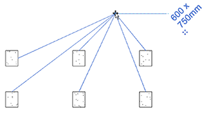

For a structural column example, to show 2 out of the 6 leaders:
Tip: To show the number of tagged elements, you need to edit the tag family, select, and edit the tag label and add the Host Count parameter from the Multi Leader Tags category drop-down.
