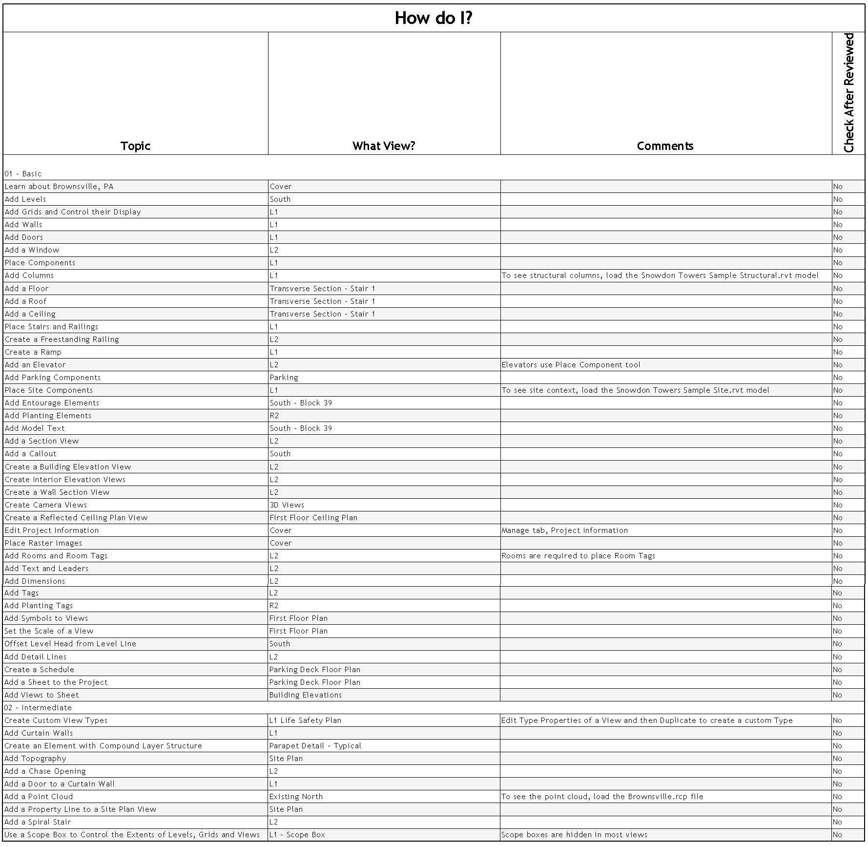

Take a Guided Tour of the Project
To learn more about the contents of the sample project look for the Help Icon near any element. Select the icon and then select the Learning Link parameter on the Properties palette. Use the browse icon: "..." to connect to the related wiki topic. (This will open externally in your default web browser). Once you have reviewed the topic click the “Content Reviewed” check box on the Properties palette.
The schedule view named: How do I lists all help topics in order from simple to more complex. You can use this view as a “guided tour” to visit all the help topics in sequence and check them off as you explore the project.
