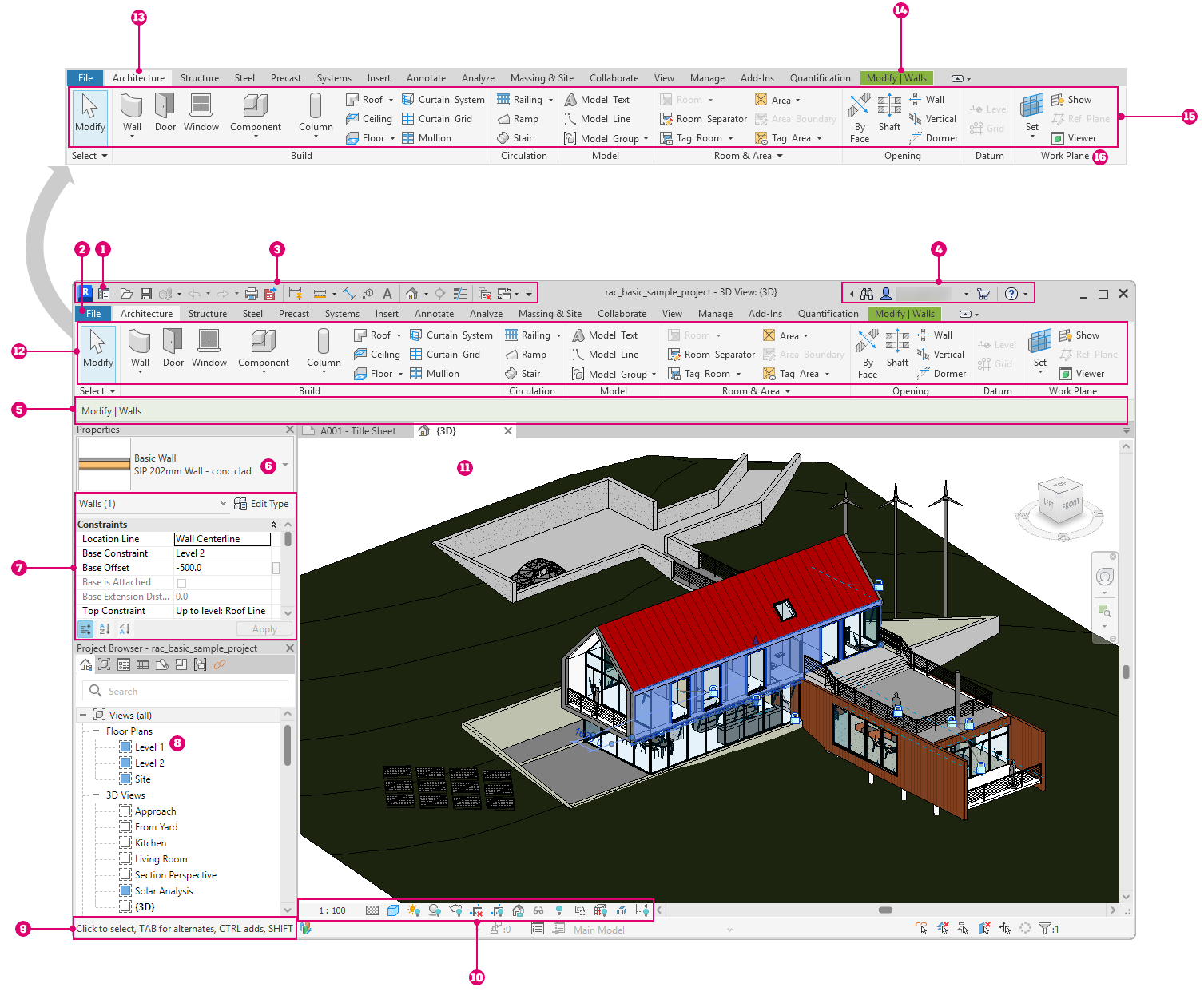

With a few clicks, you can change the interface to better support the way you work. For example, you can set the ribbon to one of 4 display settings. You can also display several model views at one time, or layer the views to see only the one on top.
Note: Your ribbon may look different if you created a user profile and tabs/tools were hidden. It may also look different if you used the User Interface section of the Options dialog to revise the ribbon.
1 Revit Home
2 File tab
3 Quick Access toolbar
4 InfoCenter
6 Type Selector
7 Properties palette
8 Project Browser
9 Status bar
10 View Control Bar
11 Drawing area
12 Ribbon
13 Tabs on the ribbon
14 A contextual tab on the ribbon, providing tools relevant to the selected object or current action
15 Tools on the current tab of the ribbon
16 Panels on the ribbon
