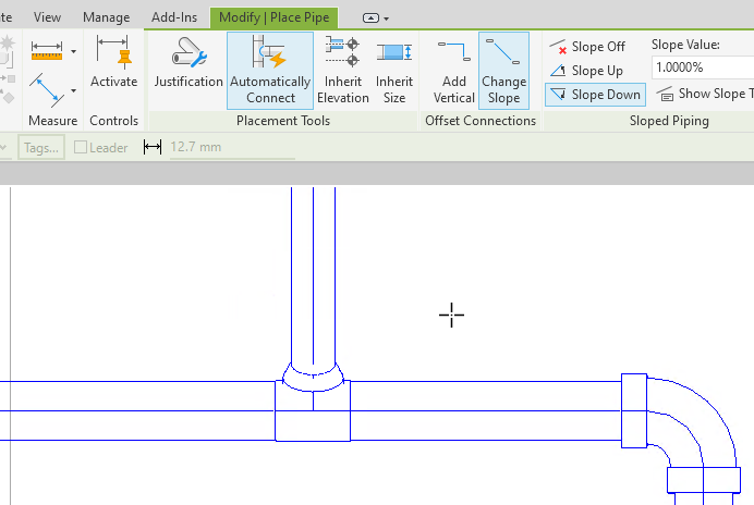

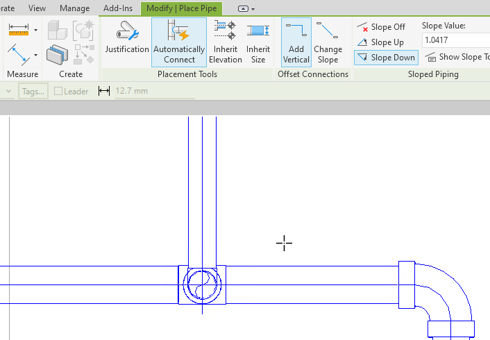

Connecting to an existing pipe with a different elevation
    To connect to an existing pipe with a different elevation, you can connect using the current slope value or ignore the slope value to connect directly.
  1. Click the Pipe command or select a pipe segment in the view.
  2. To connects directly regardless of the slope value, on the ribbon, click Modify | Place Pipe tabOffset Connection tab Change Slope.
  3. To use the current slope value, on the ribbon, click Modify | Place Pipe tabOffset Connection tabAdd Vertical.
  4. Continue drawing the pipe and connect to an existing pipe.
    The pipe is directly connected, regardless of the current slope value.
