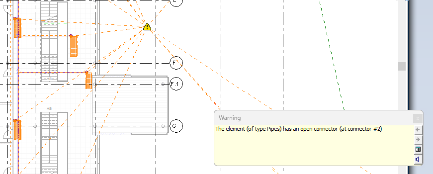

A system is considered not well connected when elements in the system are not connected into a single physical network. For example, a system with one or more air terminals not connected in a single network of duct is considered not well connected.
Click a warning marker to display a related warning message. In the related warning message, click the arrow buttons as needed to scroll the list of warning messages. Click
Expand Warning Dialog to view the details of the warning message.
