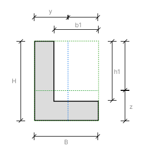

L-Shape
B. Width: the external width of the section shape.
H. Height: the external height of the section shape.
h1. Cut Height: the height of the cut in an L-shape.
b1. Cut Width: the width of the cut in an L-shape.
y. Centroid Horizontal: the distance from the centroid of the section shape to the left extremities along the horizontal axis.
z. Centroid Vertical: the distance from the centroid of the section shape to the lower extremities along the vertical axis.

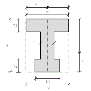

I-shape
T1. Top Flange Thickness: the distance between the exterior surfaces of the top flange in the section shape of a castellated or welded element.
b1. Top Flange Width: the external width of the top flange in the section shape of a castellated or welded element.
T2. Bottom Flange Thickness: the distance between the exterior surfaces of the bottom flange in the section shape of a castellated or welded element.
b2. Bottom Flange Width: the external width of the bottom flange in the section shape of a castellated or welded element.
t. Web Thickness: the distance between the exterior surfaces of the web in the section shape.
