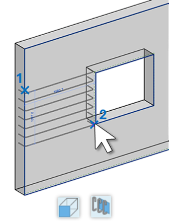

  11. Rebar placement By Two Points is not limited to 2D views. You can place bars in 3D views, aligned dynamically to the face you are hovering over. You can use the different orientations and placement planes described in the steps above while working in 3D views. Here's an example where we place a set of bars in the wall, using Near Cover and Vertical orientation. The face to which the bars are aligned is highlighted and the bars are created at the cover of that face.
