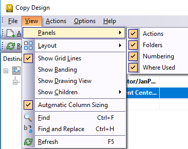

View Menu
Panels
Select which panels you want to display in the Copy Design dialog.
Layout

Show Grid Lines
Select to toggle the display of grid lines on or off in the grid.
Show Banding
Select to toggle the display of alternating color bands on or off in the grid.

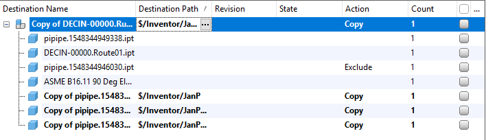

Main View Grid
The main Copy Design view shows the name of the files available for copy, destination folder, the action that will be performed on the file, the revision and state of the file, and how many instances (count) of the file occur within the current list. Whether you are duplicating a drawing, a complete design structure, or individual components, you can edit key properties during the copy process by using the intuitive copy/paste functionality or importing directly from Excel.
Tip: By default, reference file names are set to the destination file name when an action is assigned. You can view the Numbering Panel to identify files by original name or add File Name (Historical) to the main view.
You can also manage copy actions and customize the view from the main view.

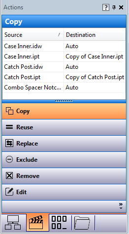

Actions
The Actions Panel lets you review which operations are assigned to be performed on files in the main view.
Once you have configured the files in the main view, you can use the Actions Panel to filter the files based on their assigned operation. Assigned operations include copied, reused, replaced, excluded, removed, or edited.
Note: You can also set action operations by dragging and dropping files from the main grid onto the desired operation button in the Actions Panel.
See Actions Panel for more information.
