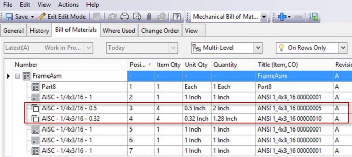

A grouped BOM row is a row that contains multiple occurrences of an item that share a single parent, but have one or more BOM row properties with different values. The different values for the BOM row properties can include, but are not limited to, Length, Quantity, and Description.
A grouped BOM row is indicated in the BOM by the Grouped icon.
Why Are Some BOM Rows Grouped?
Frequently, objects in a design come from the same stock pieces, but have different properties. For example, stock material that is cut to length or has different finishes.
These components will often have the same part number, with other properties indicating how the component differs from the original.
Because these components have the same part number, they are often combined in the CAD BOM. When that CAD BOM is imported into a vault, these grouped rows are kept in tact unless the administrator has elected not to group BOM rows as per the design BOM.
Note: Group BOM rows as per the design BOM must be enabled on the Configure Assign Item dialog for Vault retain grouped rows based on CAD BOM data. If this option is not enabled, the rows are displayed individually.

When BOM rows are grouped together, only one row is displayed in the BOM. Unless otherwise specified, the values that are displayed represent the primary BOM row's properties.
