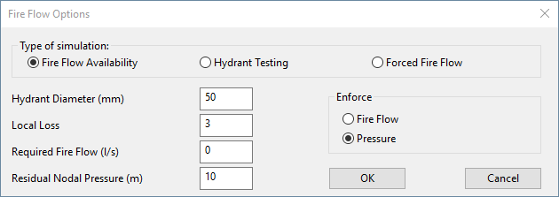

Fire Flow Options dialog - Fire Flow Availability view
This dialog view lets you set up a specialist simulation to generate additional results information to analyse fire flow availability. These extra results show the ability of individual nodes to sustain additional levels of demand for firefighting or other similar purposes.
InfoWorks WS Pro treats every node in the system as having a hydrant attached. It then estimates the flow each node could theoretically discharge, based on the pressure already present in the network. Each node is considered independently, as if no other hydrant in the system is open. This is a screening estimate, not a test of whether the hydrant would pass.

This dialog view is opened by selecting Fire Flow Availability on the Fire Flow Options dialog.
Fire Flow Options dialog - Fire Flow Availabilty view
Item Description
Hydrant Diameter
The internal diameter of the hydrant fitting. These will usually be standard throughout a network so only a single value may be entered for all hydrants.
Local Loss
Local loss representing the restriction of flow through the hydrant.
Required Fire Flow
The required fire flow from each node.
The simulation will attempt to enforce either the required fire flow or the residual nodal pressure, depending on the selection made in the Enforcefield.
Residual Nodal Pressure
The minimum required pressure at each node.
The simulation will attempt to enforce either the required fire flow or the residual nodal pressure, depending on the selection made in the Enforce field.
Enforce
Fire Flow The required fire flow is maintained until pressure at the node falls below the level which can sustain the fire flow.
Pressure The required fire flow is maintained until pressure falls to the residual nodal pressure, when fire flow is reduced in order to maintain the required minimum pressure.
