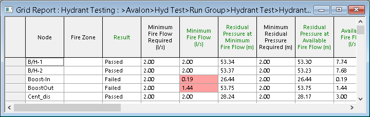

Grid Report (Hydrant Testing) view
This view displays the results of a Fire Flow - Hydrant Testing simulation.
The view is displayed in one of the following ways:
Tip: To view results on the GeoPlan up to hydrant testing time, you can right-click the hydrant testing simulation, click Open as, then select Full Replay Results on the Select Results dialog.
Item Description
Column headings Column headings are colour coded green for results and black for input data.
Unmet constraints If a constraint specified on the fire flow data or on the Hydrant property sheet of a hydrant node has not been met (minimum fire flow, for example), the appropriate field will be highlighted red in the grid.

Node: ID of test node.
Result:
  • Passed - The node will pass if the minimum fire flow required can be supplied without breaching any of the pressure constraints applied. Constraints are checked with a numerical tolerance of 0.1%, so a value within 0.1% of the requirement (for example a residual pressure of at least 99.9% of the Minimum Residual Pressure Required) is treated as met.
  • Failed - The node will fail if the minimum fire flow required cannot be supplied without breaching any of the pressure constraints applied.
  • Unknown - The test result will be unknown if the node is not tested (for example, if hydrant flow has been set up on the Hydrant Flow Profile page of a test node), or if the simulation fails to converge.
Minimum Fire Flow Required: Minimum flow required to satisfy fire protection needs. The minimum flow value is specified by the user in the Fire Flow Data Item or on the Hydrant Property Sheet of a Hydrant node.
Minimum Fire Flow: The smaller of the user defined Minimum Fire Flow Required and calculated Available Fire Flow at the test node.
