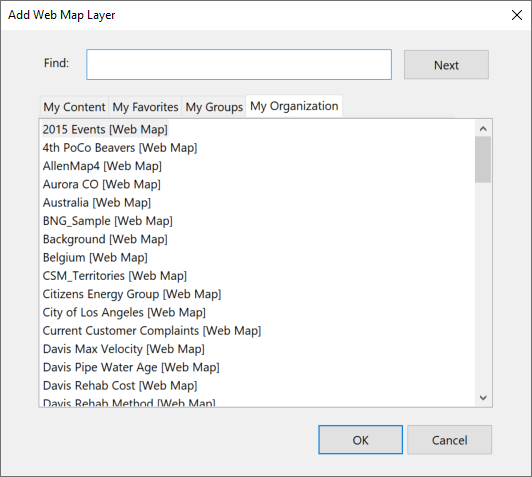

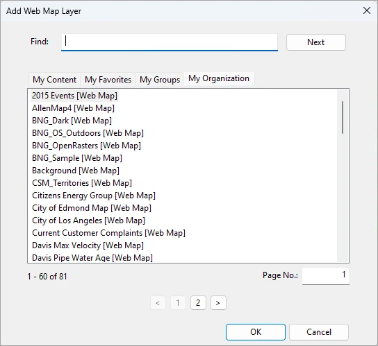

This dialog is displayed from the GIS Layer Control dialog when Layer Type is set to Web Map and you click Add Layer.
It is used to select a single Web Map from ArcGIS Online to be used as an additional GIS layer in the GeoPlan window. The coordinate system for the Web Map should match the coordinate system for the GeoPlan. The Web Map layer is a special layer that does not have any settable properties and is always the bottom most layer in the GeoPlan.
The contents of the tabs for "My Content", "My Favorites", "My Groups" and "My Organization" correspond to the contents in equivalent tabs in ArcGIS Online under "Content".
| Item | Description |
| Find | Finds an online map layer. Specifying all or part of the map layer name you want to find into this field highlights the first instance of it in the list. |
| Next | Scrolls to either the next item in the list or, if you have specified any part of a layer name in the Find field, the next instance if it in the list. |
| My content | A list of online map layers.
Note: The tabs are populated according to what is stored on your ArcGIS online account.
| My Favorites | |
| My Groups | |
| My Organization | |
| [Number of items] | The number of currently displayed items and the total number of items for the selected tab. Each item represents an online map layer. |
| Page No. | Displays the current page number. You can use the arrow button to move to the next page or go back to the previous page. |
| OK | Selects the online map layer highlighted in the list and closes the dialog. |
| Cancel | Cancels the operation and closes the dialog. |
