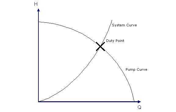

System curve
The system curve relates the pumping head required, H P to discharge, Q. The operating point, (duty point), of the pump occurs where the system curve and the pump curve intersect.

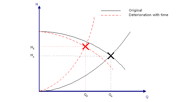

As the mechanical parts of the pump deteriorate with use over time, the duty point of the pump will move (for a given head required the flow will decrease, i.e. the pump curve will move downwards). Also, as the system pipework deteriorates and becomes rougher, the system curve will become steeper. Over time, a significant decrease in pump output may occur.
Effect of wear on pump
If pump testing has been carried out since the pump was installed, the characteristics from the test results can be used to provide a more accurate, up to date curve for the pump. Alternatively, a throttle can be applied to the pumping station to simulate the deterioration of the pump.

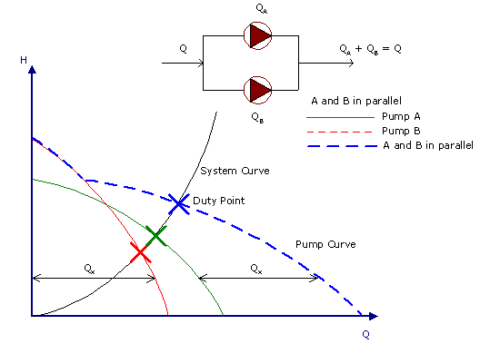

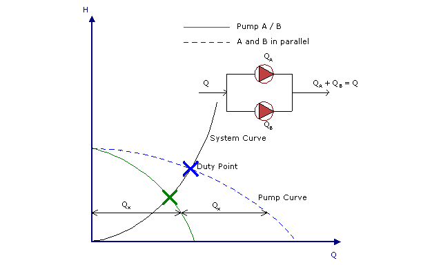

Pumps in Parallel
Operating characteristics for a PST with two pumps in parallel are shown in the figures below:
Similar Pumps in Parallel
Dissimilar Pumps in Parallel
InfoWorks WS can handle stations with several units in parallel easily. More information is contained in the About pumping stations section.
