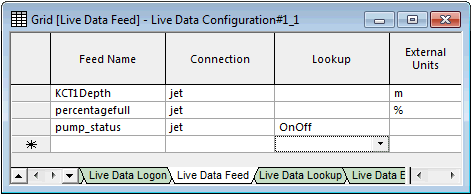

Live Data grid - Live Data Feed view
This view is used to specify connections to feeds in one or more telemetry databases.
The view is displayed by double-clicking a live data configuration object in the Model Group window, then selecting the Live Data Feed tab.
Live Data Feed tab
Notes:
Item Description
Left-most column
If clicked, selects the whole row.
A forward triangle indicates the current row.
An asterisk indicates where a new object can be created by entering its details (in this case, by selecting a lookup table).
Fields
