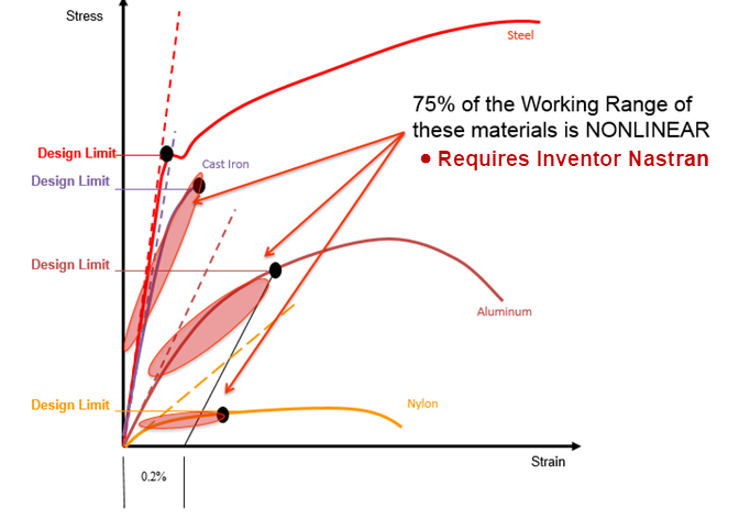

As you can see in the image below, nylon, aluminum and cast iron are materials with 75% of their working range in the nonlinear state. They require the use of an FEA program like Inventor Nastran to calculate the structural response to operating loads.

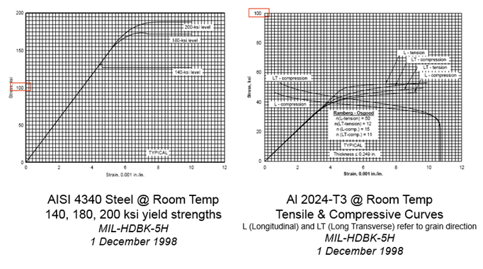

Stress-strain curves for metals are typically measured in tension or compression tests. The tensile test for metals is ASTM E8 and allows for multiple strain rates and material temperatures. The graphs below show stress-strain curves for 4340 Steel and 2024 Aluminum. You can see that the steel curves show a consistent slope, or Young’s Modulus until yield. The aluminum curve shows the variation in stress-strain response as different material orientations are examined. The curve also shows that 2024-T3 is asymmetric in that its tensile and compressive responses differ.
Both these curves were extracted from Mil Handbook 5H, a publicly available resource with a lot of good material reference data.

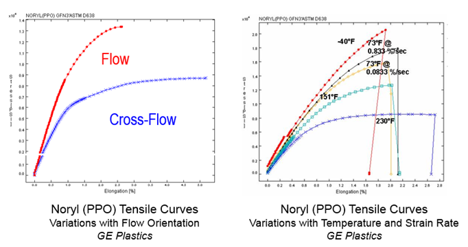

These curves below for Noryl, a GE Plastics PPO, were measured using ASTM D638, the standard tensile test for plastics. The curve on the left shows how the stress-strain relationship in plastics can vary with injection molding flow direction. The curves on the right show how the same material can have differing stress-strain responses at different strain, or loading, rates and temperatures.
From these brief examples, you can see how quickly a nonlinear material investigation can get very complex. Therefore, we recommend that you get the most applicable stress-strain data for the material you are using or considering to determine if material nonlinearity is even an issue for the strain levels you are operating in. This level can be determined from an initial linear material analysis. If you decide you need to use a nonlinear material model, try to find the curve that best represents your expected environment. Then, if necessary, bracket the results with 2-3 different curves to see how sensitive the response of interest is to this nonlinearity. If there is a difference and you can’t decide which material model is most correct, choose conservatively or back up your analysis with test data.

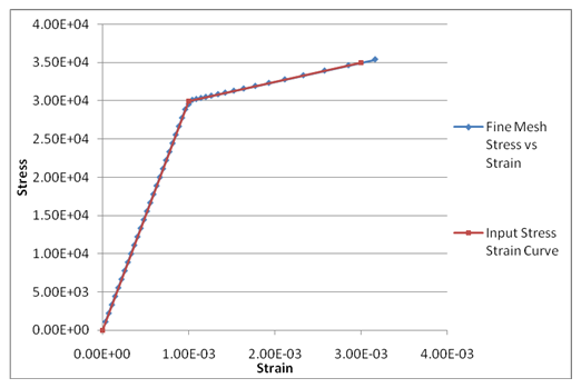

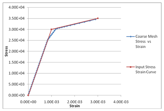

The two images below show the stress-strain curves for two different mesh density. You can see how a finer mesh follows the input stress-strain curve more accurately.
It is also important to note that since the corner stresses are extrapolated from the Gauss points, their stress values can often exceed the stress values on the stress-strain curve. If there is a large difference between the center stress values and the corner stresses, it is recommended to refine the mesh to get a more accurate representation of the yielding that is occurring.
