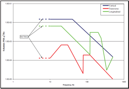

In the previous exercise, we saw that there were normal modes (natural frequencies) that corresponded to higher energy road load inputs. Ideally, the muffler should not excite at those frequencies. If we can modify the design to push the questionable modes out of the peak energy portions of the curve, we will minimize the chance that vibration-related fatigue will occur. The process of moving modes to avoid high energy or excitation frequencies is called modal avoidance.

The 380 Hz and 410 Hz modes are very near the drop off region in the road load longitudinal curve. Pushing these modes up 20 to 25% could reduce their sensitivity to this frequency. We can thicken the bulkheads and end caps to shift these modes.

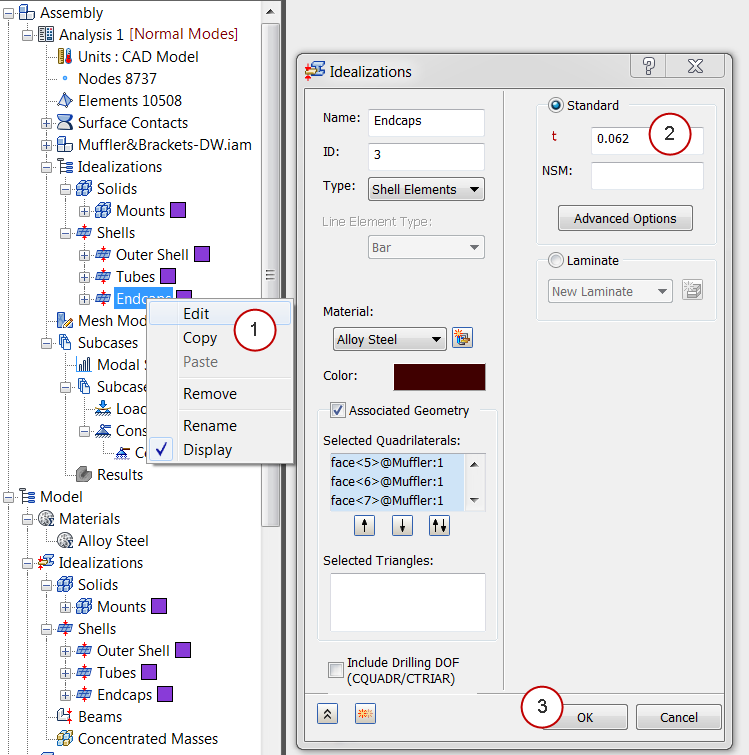

  1. From the Analysis tree, right-click on Endcaps from the Idealizations list, and click Edit.
  2. Change the thickness, t, to 0.062.
  3. Click OK.

Similarly, the 102 Hz mode is close to the drop off in the road load transverse curve. This would require a 200-330% increase to justify the change. However, increased material thickness on a small part will have a minor cost impact.

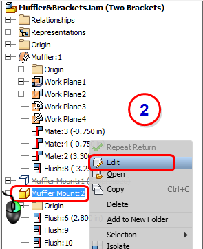

  2. Right-click on Muffler Mount:2, and select Edit.

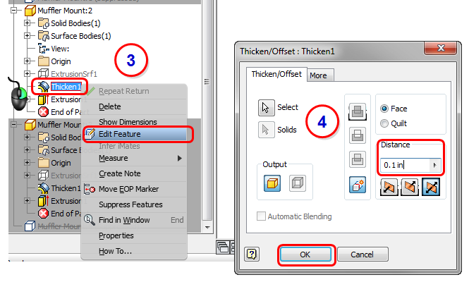

  3. Right-click on Thicken1, and select Edit Feature.
  4. Enter a Distance of 0.1, and click OK.

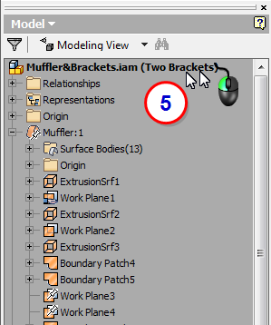

  5. Double-click on the top branch: Muffler&Brackets.iam (Two Brackets).
  6. Repeat steps 2-5 to change the thickness of Muffler Mount:3 to 0.1.

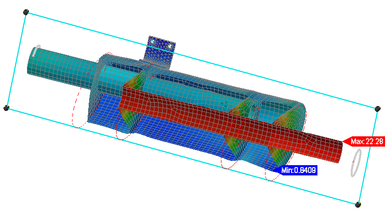

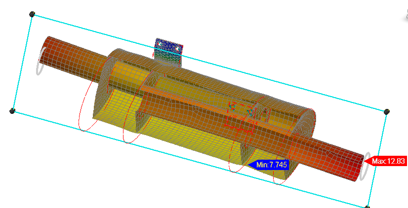

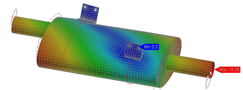

  1. Click Options, and expand the Subcases menu to see the frequency for each mode.
First Design
Second Design
Mode Shape
Mode 1
95
101
Same
Mode 2
379
564
Transverse
Mode 3
405
625
Longitudinal Oil Canning
We can see that the longitudinal modes were pushed exactly where they needed to go to minimize the possibility of vibration-related failure.
Mode 1:
Mode 2:
Mode 3:
